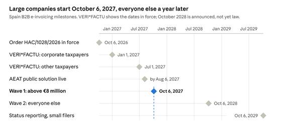

The dates that matter
Spain B2B e-invoicing and VERI*FACTU milestones, 2026 to 2029
Every e-invoicing date counts from October 6, 2026, the day the order took effect. The AEAT must open its public solution at least two months before the first wave goes live.
