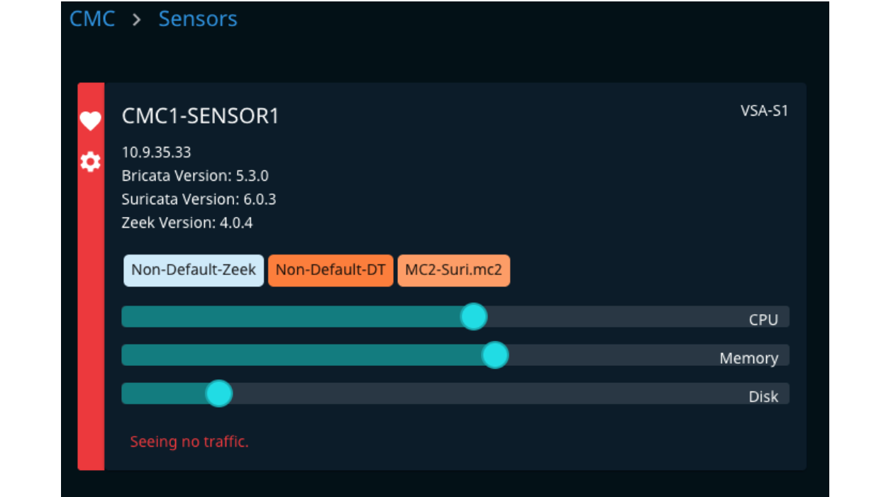

  • Step 2 – Navigate to Sensors and click on the ‘Gear’ icon for the registered sensor you wish to utilize for the replay.

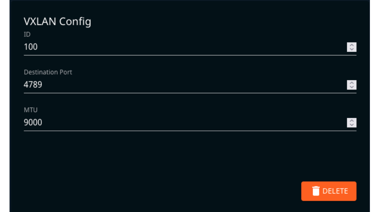

  • Step 3 – In the VXLAN configuration area, fill in the VXLAN ID, Destination Port, and MTU. Note this information for use later in the TCP Replay system setup.
  • Step 4 – Save the configured options by clicking the Update button directly under the VXLAN configuration box

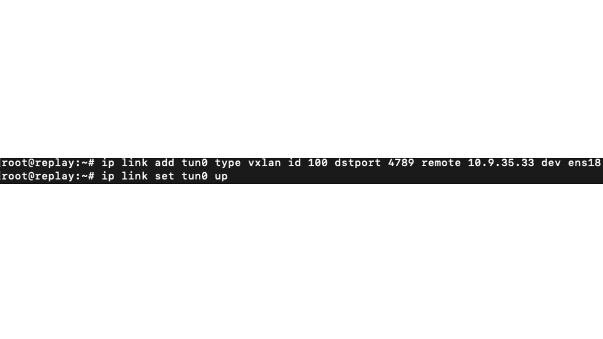

As root or using sudo, set up a VXLAN tunnel to your sensor’s IP interface with the below command sets. (please note: variables have been used in these commands, please replace $vxlan_id, $sensor_ip, and $dstport with information noted in the sensor configuration above. Replace $source_int with the ethernet interface information from your Linux system being used for TCP Replay.
  • “ip link add tun0 type vxlan id $vxlan_id dstport 4789 remote $sensor_ip dev $source_int”
  • “ip link set tun0 up”
No output is expected from each command unless an error has occurred. You can check the tunnel’s status by running “ip link” command.

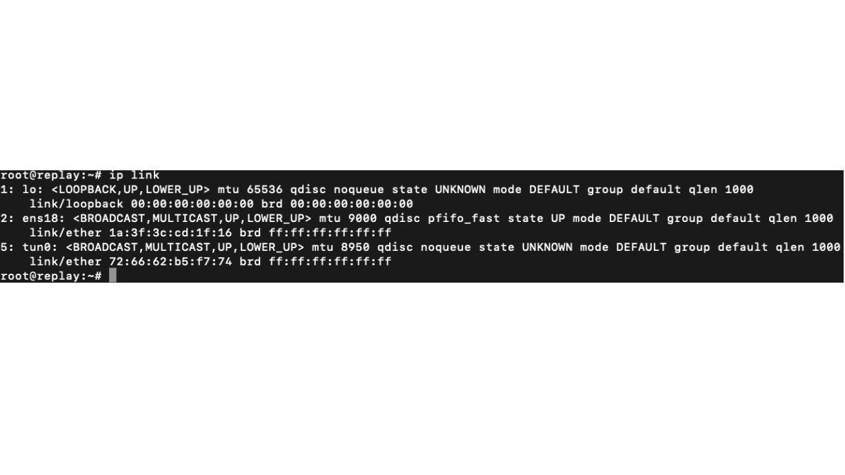

Check to ensure the VXLAN tunnel has been established by using: “ip link” and look for “tun0” with a status of “up”.

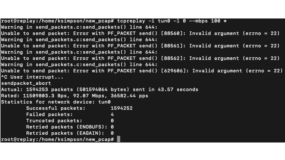

In this example, we will play back our PCAP files at 100 Mbit on infinite loop against interface tun0. Alternatively, you may run the replay continuously and perform a CTRL+C when finished.
As root or using sudo:
  • “tcpreplay -i tun0 pcap.file” – This will play the file once against the VXLAN tunnel.
  • “tcpreplay -i tun0 -l 0 pcap.file” – This will play the file in a continuous loop against the VXLAN tunnel.
  • “tcpreplay -i tun0 -l 0 –mbps 100 pcap.file” – This will play the file in a continuous loop at 100 Mbit against the VXLAN tunnel.
